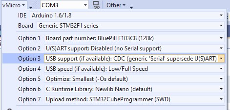

And also provide all options sets in the Arduino menu, please.

I am using Visual Micro.
Annotation 2020-04-01 112459.jpg (43.42 KiB) Viewed 8490 times
Even setting "Wire.setClock(100000);" stops USB and I get a windows message "USB Device not recognised etc", and the LED does not blink.
The programme seems to compiles and uploads OK.
As you can see I have remmed out most things.
