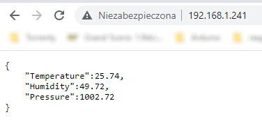

jarwil
Posts: 12
Joined: Wed Nov 23, 2022 2:06 pm
Re: Netduino Plus 2 board + BME280
Post by jarwil »
One of Murphy's laws says:
It works better if you plug it in.
What I wanted to do, I have already done on BluePill and a separate ENC28J60. The netduino board was already intended for the archive box.
Thanks to your answer, I gave Netduino another chance :)
This time I decided to check HW.
What was my surprise when I saw that where there should be 5V there was 0V. The sensors I tested had no power.
A quick glance at the diagram and everything became clear :)
Now it work perfectly.
Also the ethernet works well.
Thank You!
